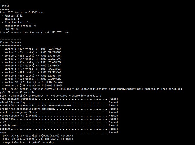

제출 내용 1: 수정된 unit test code (스크린샷 또는 실제 코드)
제출 내용 2: 아래의 예시와 같이 tox를 통해 모든 unit test 통과한 화면

Failed 1 tests - output below:
openstackclient.tests.unit.compute.v2.test_server.TestServerCreate.test_server_create_with_block_device_from_file
Captured traceback:
    Traceback (most recent call last):
      File "C:\Users\lenovo\Git\2025-OSCA\OCA-OpenStack\python-openstackclient\openstackclient\tests\unit\compute\v2\test_server.py", line 2736, in test_server_create_with_block_device_from_file
    parsed_args = self.check_parser(self.cmd, arglist, verifylist)
      File "C:\Users\lenovo\Git\2025-OSCA\OCA-OpenStack\python-openstackclient\openstackclient\tests\unit\utils.py", line 86, in check_parser
    parsed_args = cmd_parser.parse_args(args)
      File "C:\Program Files\WindowsApps\PythonSoftwareFoundation.Python.3.12_3.12.2800.0_x64__qbz5n2kfra8p0\Lib\argparse.py", line 1904, in parse_args
    args, argv = self.parse_known_args(args, namespace)
      File "C:\Program Files\WindowsApps\PythonSoftwareFoundation.Python.3.12_3.12.2800.0_x64__qbz5n2kfra8p0\Lib\argparse.py", line 1914, in parse_known_args
    return self._parse_known_args2(args, namespace, intermixed=False)
      File "C:\Program Files\WindowsApps\PythonSoftwareFoundation.Python.3.12_3.12.2800.0_x64__qbz5n2kfra8p0\Lib\argparse.py", line 1943, in _parse_known_args2
    namespace, args = self._parse_known_args(args, namespace, intermixed)
      File "C:\Program Files\WindowsApps\PythonSoftwareFoundation.Python.3.12_3.12.2800.0_x64__qbz5n2kfra8p0\Lib\argparse.py", line 2184, in _parse_known_args
    start_index = consume_optional(start_index)
      File "C:\Program Files\WindowsApps\PythonSoftwareFoundation.Python.3.12_3.12.2800.0_x64__qbz5n2kfra8p0\Lib\argparse.py", line 2113, in consume_optional
    take_action(action, args, option_string)
      File "C:\Program Files\WindowsApps\PythonSoftwareFoundation.Python.3.12_3.12.2800.0_x64__qbz5n2kfra8p0\Lib\argparse.py", line 2018, in take_action
    action(self, namespace, argument_values, option_string)
      File "C:\Users\lenovo\Git\2025-OSCA\OCA-OpenStack\python-openstackclient\openstackclient\compute\v2\server.py", line 1068, in __call__
    with open(values) as fh:
    PermissionError: [Errno 13] Permission denied: 'C:\\Users\\lenovo\\AppData\\Local\\Temp\\tmpgr_188ci'
또한 현재 저는 Window 환경에서 테스트를 수행하고 있기 때문에 위와 같이 temp 파일을 다루는 테스트 로직 상에서 PermissionError가 발생하였습니다.
# python-openstackclient/openstackclient/tests/unit/compute/v2/test_server.py
class
import os
TestServerCreate(TestServer):
    def test_server_create_with_block_device_from_file(self):
        self.set_compute_api_version('2.67')
        block_device = {
            'uuid': self.volume.id,
            'source_type': 'volume',
            'destination_type': 'volume',
            'disk_bus': 'ide',
            'device_type': 'disk',
            'device_name': 'sdb',
            'guest_format': 'ext4',
            'volume_size': 64,
            'volume_type': 'foo',
            'boot_index': 1,
            'delete_on_termination': True,
            'tag': 'foo',
        # with 문을 제거하고 파일을 직접 열기
        fp = tempfile.NamedTemporaryFile(mode='w+', delete=False)
        # 테스트 종료 후 파일을 자동으로 삭제하도록 예약
        self.addCleanup(os.remove, fp.name)
        json.dump(block_device, fp=fp)
        fp.flush()
        # 파일 핸들을 명시적으로 닫아줌
        fp.close()
        # with tempfile.NamedTemporaryFile(mode='w+') as fp:
        #     json.dump(block_device, fp=fp)
        #     fp.flush()
        arglist = [
            '--image',
            self.image.id,
            '--flavor',
            self.flavor.id,
            '--block-device',
            fp.name,
            self.server.name,
        verifylist = [
            ('image', self.image.id),
            ('flavor', self.flavor.id),
            ('block_devices', [block_device]),
            ('server_name', self.server.name),
        columns, data = self.cmd.take_action(parsed_args)
이는 Windows 환경에서 tempfile로 생성된 임시 파일에 접근할 때 발생하는 전형적인 권한 문제로 test_server_create_with_block_device_from_file() 메소드에서 with 문을 제거하고 직접 파일을 생성하고 테스트 종료 후 자동으로 삭제하도록 예약합니다.

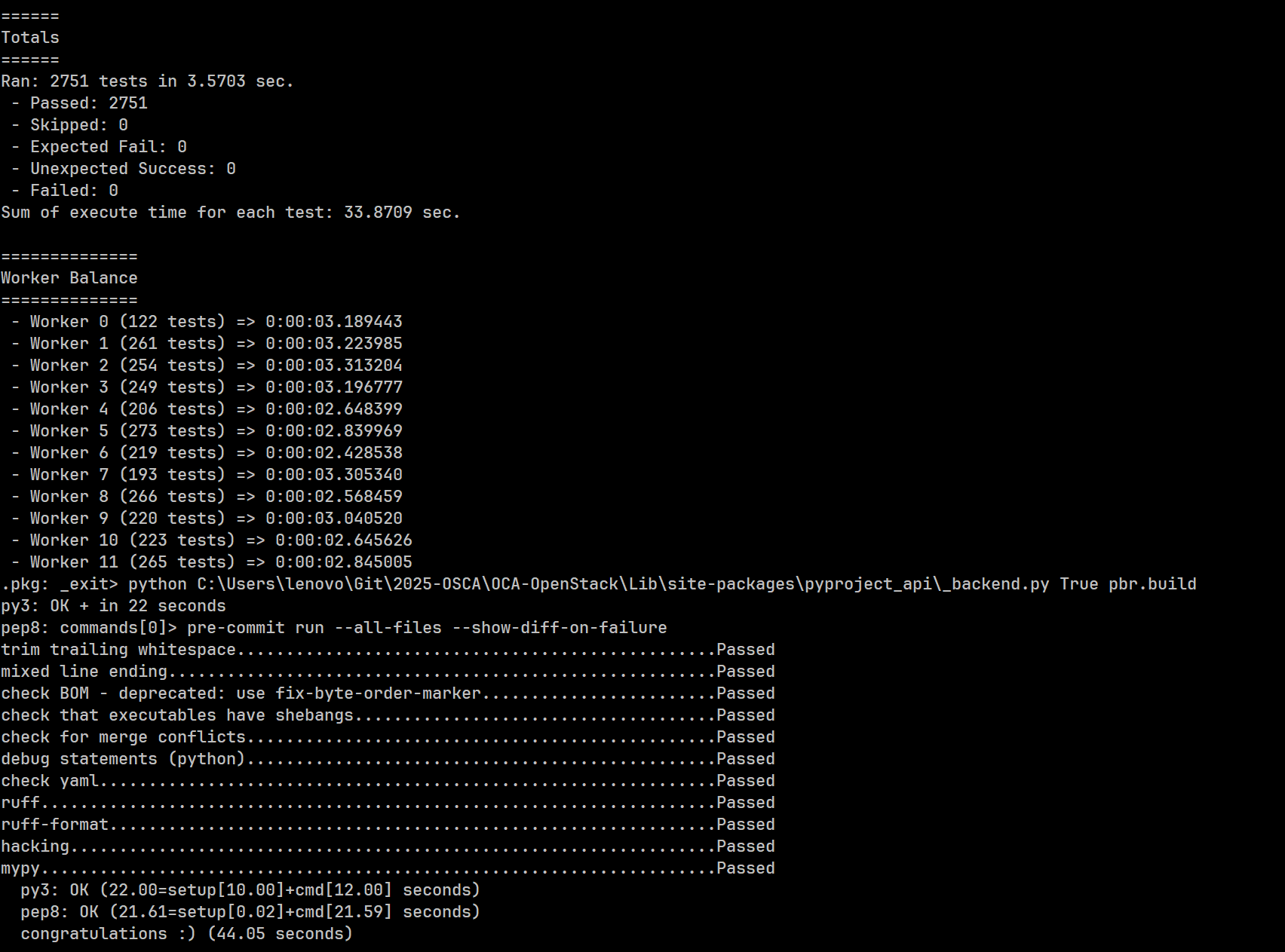

최종적으로 위와 같이 새롭게 만들어진 Fake Identity에 대해서 모든 테스트가 정상적으로 수행됨을 볼 수 있었습니다.
멘토님께서 말씀주신 내용에 따라 새로운 Fake Identity가 아니라, 기존에 생성된 Fake Identity를 사용하는 방식으로 변경을 시도해볼 예정입니다.
